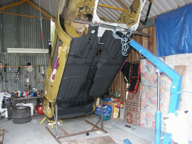

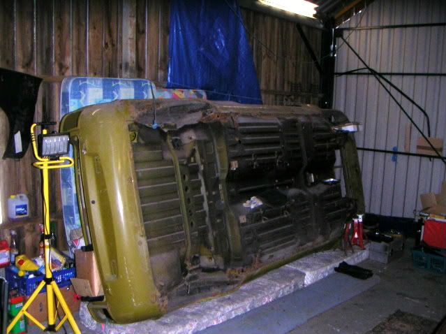

I rolled my 2 door shell over on old mattresses (go visit your local "Beds and Mattresses" place, they usually have a skip full of them!). It seems to have survived ok Very Happy
I also made up a stand for it (bolted to the suspension mounting points). I don't really know why I did this now but it was fun at the time!! Well, actually, it was bloody scary but we survived this too LOL! Shocked
I can email more pics if you want.

giz
Site Admin
Joined: 18 Jun 2011
Posts: 377
Location: Bromsgrove
PostPosted: Tue Oct 04, 2011 1:45 pm    Post subject: Reply with quote
those are fantastic photos! i think i'll just stick with rolling it over though Laughing
your floor looks in a lot better condition than mine Sad
