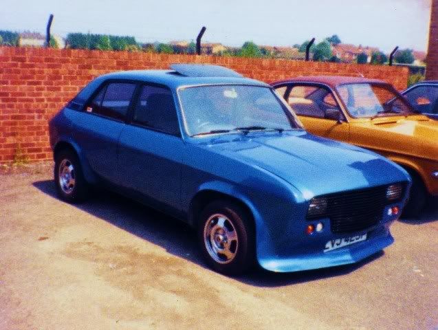

PostPosted: Sat Apr 02, 2011 9:17 am    Post subject: Reply with quote
Such a shame that car seems to have vanished, I'd love to know more about who did it, how and why.
Frankie (neé Fanjita) is undergoing a slow metamorphosis with a 2.0TD L-series engine, and possibly I'll look at cosmetic upgrades later. I doubt it'll be quite as fast as Jonny Smith's "Project Retirement Rocket" 2.7 V6 Allegro but it'll be much more economical Wink (Despite the lack of progress on the blog since 2009, I know this car has been completed as he's had it insured since earlier this year… Might have to poke him for a new update!)
Of course, no discussion of customised Allegros would be complete without All-Ego!

PostPosted: Sun Apr 03, 2011 9:32 am    Post subject: Reply with quote
Bit spooky, bringing up all-aggro - wasn`t that an ex-Andy Robinson motor too...

PostPosted: Sun Apr 03, 2011 6:47 pm    Post subject: Reply with quote
most be andys fault then as i have brought mine from andy too!!!!!!
i do like the whole custom but im not really wanting to change the look of my car as in shape think whom ever did it well they most of loved the car and think they have done a great job just not my kind of thing nice exhaust, sports paint and nicer seats yeah thats me !
